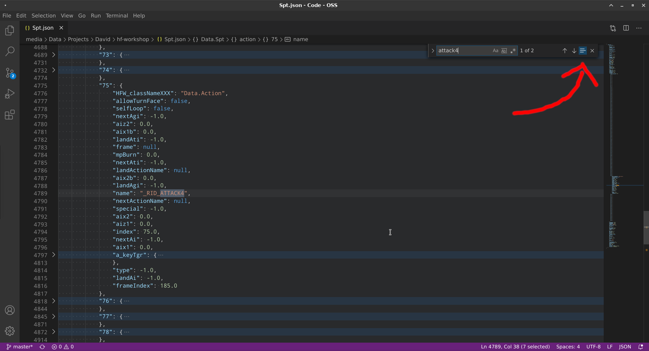

Going back to our action array (line 2346), we will now search in it for the string array4. In VS Code, you can select the collapsed array, then press Ctrl+F, and select the icon to Find in selection (Alt + L), as shown in the picture below.
[Image: spt2.png]
The first action we found is in the 75th position of the action array, and has name _RID_ATTACK4. Because it has the _RID_ prefix, this probably refers to the attack while riding, which is not what we're looking for right now, so we press the down arrow or enter to keep looking. We then find the action with name ATTACK4 in position 82, this is what we want, and we change the attribute allowTurnFace to true.
