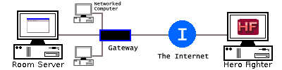

It is easiest to explain this graphically, with the animated image below.
The three computers on the left are behind a local area network, and connect to the Internet via the gateway. This gateway can be a piece of hardware such as the "routers" found at computer stores, or it can be another computer set up with multiple network cards and configured to act as a gateway. With either kind, the concept is exactly the same.
The Room Server obtains the computer IP on the LAN (Local IP) and the gateway IP on the WAN (Public IP). Then it sends its public address to the server list in case the room is open to public. So far, so good. Here is where the trouble occurs: when the Hero Fighter client tries to join the room (or when the server list tests if the room is accessible in case it is open to public), all requests to the room server are blocked because the gateway doesn't know what to do with them. When the data packets hit the gateway, all they specify is the address of the gateway. There is no way for the gateway to know which computer on the network the request should go to. So it blocks it.
